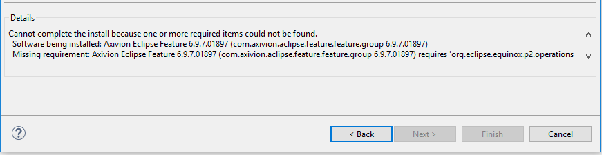

i´ve some trouble with installing a plugin in the EDS Suite. I am using Quartus Prime Lite Edition (v. 18.1).
When I try to install the plugin, it fails because it could not find the installed dependency.

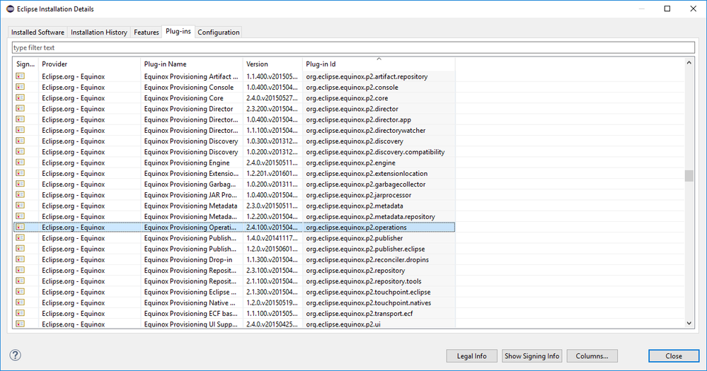

The missing dependency are there and installed. I find these in the Eclipse Installation Details.
My question is, how to install the plugin? Or what is special about NIOS II EDS that i could not install the plugin?

I do not think so. We have installed some other versions of Eclipse and there, the plugin is running.
Unfortunately the customized version of Eclipse, the NIOS2 EDS has anything special changed, that we couldn´t install the plugin. The requirements are installed, but the plugin doesn´t find it.
