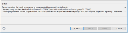

Hi there, i´ve some trouble with installing a plugin in the EDS Suite. I am using Quartus Prime Lite Edition (v. 18.1). When I try to install the plugin, it fails because it could not find the inst...

6 years agoI hadn´t uesed a third party plugin to install my required plugin.
As I mentioned before - I solved the problem by copying, pasting and merging files of my required plugin and the NIOS2 Eclipse.
Example:
I have to add the .jar files in artifacts.xml. Also I have to paste the .jar files into the dir /plugins and /features.
And so on...
