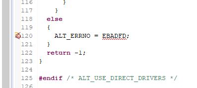

#1 alt_read.c
Line 120 appears to have an error:
ALT_ERRNO = EBADFD;
should be
ALT_ERRNO = 0xEBADFD;

  • SeanAB's avatar
    SeanAB
    The issues is in Eclipse. In the HAL source alt_read.c file, the attached bug appears. Again not sure if this is really an bug as the application builds and runs without issue.
