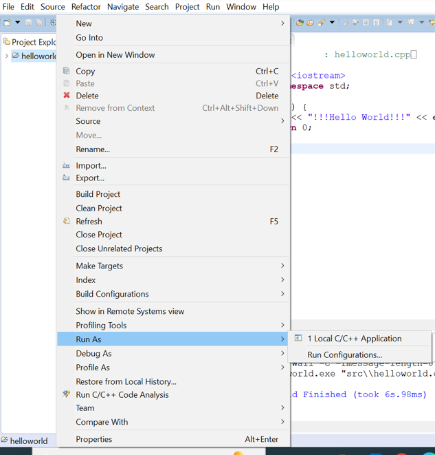

Not finding run as nios II hardware option from eclipse
I am trying to work with the hello world template. The project is built successfully, but I am not finding any option there to run my application on the nios II hardware(attaching screenshot for reference).
Note: The quartus version used to build the project is 20.1

    you are using Eclipse is freshly installed software ?
    if it freshly installed, before install pls follow bellow steps

    in you shared image at project explore section BSP folder is not there. first generate BSP package.
