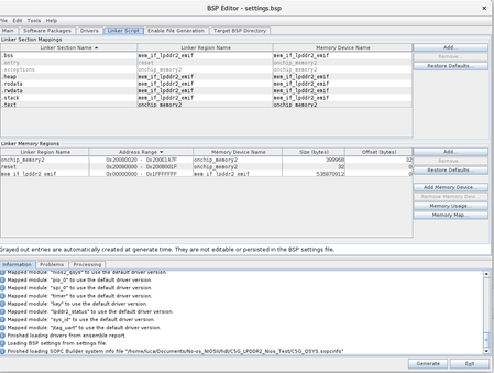

nios2 on cyclonev gx, software boot at power up
- 2 years ago
Instead of .pof you use a .jic.
You can check the Embedded Design Handbook on the EPCQ booting method on XIP (Execute in place) from EPCQ programming:
https://www.intel.com/content/www/us/en/docs/programmable/683689/current/programming-96050.html
Once you have programmed, you can power cycle your board and it will load your hardware and software file from the .jic in the EPCQ flash.
