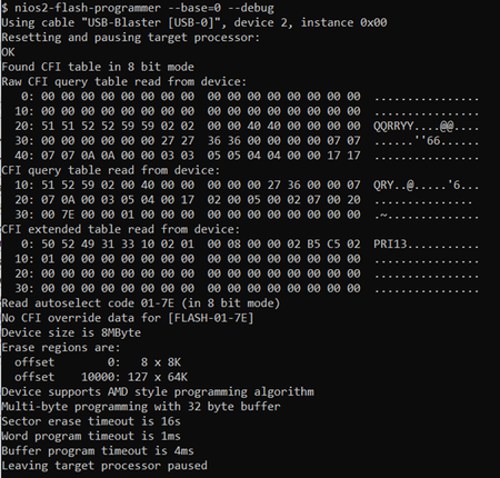

I have a board, which original use a flash, which is S29GL064N90BFI04(Cypress), but this one is EOL, so we want to use MX29LV640EBXEI(Macronix) to replace it. We program outline with Macronix flash,...

2 years agosorry to bother you, I have made it.
in the command line, add "--width=8", then it works
