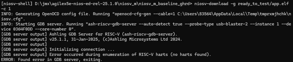

Nios V: niosv-download reports "no harts found" on Agilex 5 board

Hi, I have tried to change my design but still shows this output when I run the command NIosV download. I will have a look at the links you attached, thank you so much for your quick reply!
- JMX11 months ago
And also I have tried the ready-to-test in this link https://github.com/altera-fpga/agilex5e-nios-ed. I download the .sof file to the board through Quartus Prime Pro 25.1 -> Tool -> Programmer -> Change File ->top.sof, then run the command NiosV download, the command shell still shows the error.
