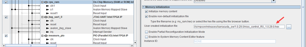

[NIOS] New CPU Memory HEX file -> should all NIOS system be regenerated?
When the NIOS Memory HEX file is replaced with a new one -> should all NIOS subsystem be regenerated (new RTL file will be created)?
Can not I leave the whole NIOS system untouched and just replace the NIOS Memory HEX file?
Thank you!
  • You do not have to regenerate the NIOS sub-system if you change the .hex file that you are using to initialize the memory.
    You only have to do 2 steps in Quartus:
    1) Run 'Update Memory Initialization File' in the Processing menu.
    2) Run 'Start Assembler' under 'Start' in the Processing menu.
    This will create a new SOF file using the new .HEX file.

    • amildm's avatar
      amildm
      The question was a bit different ....
      I already have a new .HEX file - received it from out SW group.
      But, when I replace the "old" .HEX with the "new" .HEX (shown in the GUI screenshot in my previous post), QSYS wants to re-generate the whole NIOS subsystem (RTL generation).
      Why? The .HEX, which I received, is based on the same NIOS configuration. The only thing, that has been changed, is the Memory (ROM/RAM) contents, which NIOS works with... I mean no logic has been changed, only memory contents have been changed - so why the whole NIOS subsystem RTL should be re-generated?

    • amildm's avatar
      amildm
      As for the above flow ('Update Memory Initialization File' and then 'Start Assembler'), will this also re-compile the FPGA logic or will leave it the same as before updating the Memory Initialization File?
      Will the above flow update the NIOS memory only or will it update ALL the INIT files for ALL the Memories in the given Project?
      Thanks!
  • RProesel's avatar
    RProesel
    It will not recompile the FPGA logic and will leave it the same as before updating the memory files. It will update all the memories, but it the only thing you changed was the NIOS code, any other memory contents will be the same as it was from the compile.
    I have been using this technique for many years for exactly the reason you explained.
