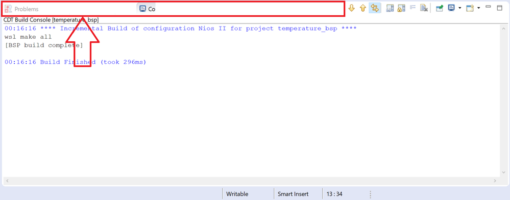

In Q19.1 Std Eclipse is completely broken with Windows 10, there are a lot of video artifacts during debug that make the screen unreadable. I would like to see an updated version of Eclipse supported with the the Nios plugin.

1) Yes I followed that instructions
2) There is no error message but the screen is not redrawn correctly and I can't properly see the buttons on the bottom (ex. to switch from the Debug log to the Console)
I am on a 4K monitor, using High DPI scaling override "System Enhanced"

- ltazz1
Attached an example of visual artifact that I don't have with previous versions of Eclipse/Nios

- MEIYAN_L_Intel
It is a 4K monitors graphic problem for Quartus Prime software in Window 10.
I had just found that the developer had known this issue and plan to solve in future.
Unfortunately, the only workaround is downscaling to 1080.

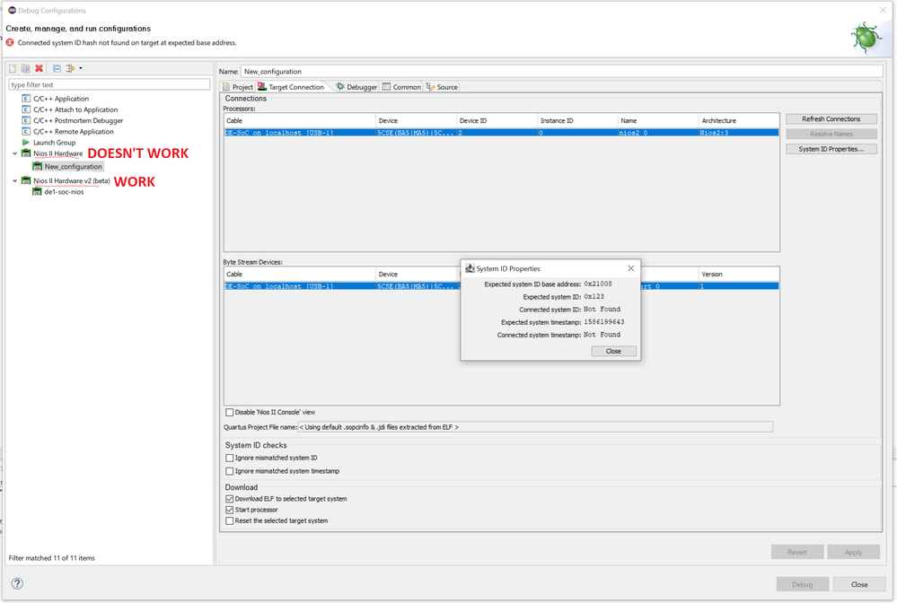

I found another bug, Eclipse is not detecting the System ID, a 0 or "Not found" is displayed when analyzing the target connection (see attached picture).
Using system-console I can read the right data at the system id MM address
Using Nios II Hardware v2 (beta) configuration seem to fix the issue (only some times). but this is very bad!
