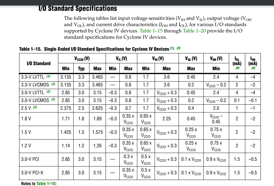

      I am using the GPIO between a tri-state and a logic low.
      When a logic low, it is connected to a solid state relay (in essence a forward bias diode with Vf typ 1.2V), tied to +5V. There is a 1.91k ohm resistor in series. Thus the sourcing current when driving a logic low would be 5-1.2/1.91k approx 2mA.
  • We also would like to know what will happen if toggle the gpio without connecting the relay.
  • Michael-C's avatar
    Michael-C
    I have tested the GPIO with the series resister removed, when tri-state it floats around 0.8V. When it drive a logic low, it sets the voltage to 0.0V
