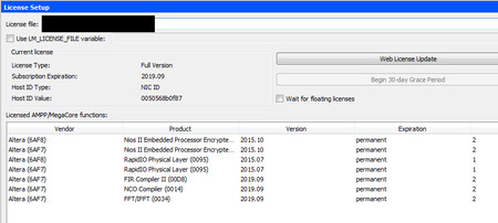

7 years agoNios II expired with Quartus Prime still valid for 2 months. Does Nios II require separate licensing? Please see details and attached screenshot. Thanks! G
Hi G, I have not touched NS5 FPGA projects for perhaps 7-8 months, and last week I found out that I can no longer compile the NS5 FPGA Nios using Quartus full version 10.1 (the version we always use...

Welcome to INTEL forum. May I know, have you re-generate your license file? Only the license administrator can re-generate the license file.
Guidance: https://fpgasupport.intel.com/AlteraLicensing/license/index.html --> Licensing Center Home --> Computer and License Files --> Select a computer to generate a new license file.
Link to demo: https://www.intel.com/content/www/us/en/programmable/support/training/demonstrations/online/licensing/onl-licensing.html
