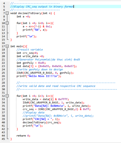

I am using Quartus Prime Lite18.1 and i have a program like in image below
My issue: The 35th line in my code causes my program to be stucked (i mean, all of further code lines are not implemented).
Help me. Thanks a million.

    It seems like the code stopped at line34 where you are writing to the address of CRC_WRAPPER_0_BASE.
    What is this address that you are writing to? Is it an IP that you are interfacing with?
    What is expected when you are writing to this address?

      CRC_WRAPPER_0_BASE is a base address of IP whose name Serial CRC Calculator, and I certainly confirm that the 34th line is successfully done (i have seen waveform, data is successfully written down to my design). But as program are progressing until 35th line, it is stuck here (all further code lines are not implemented).

    How about the line 36?
    Could you try removing line 35, as it is just a prinout for logs.
    See if line 36 is running with line 35 is commented.

      Removing or commenting the 35th line is valid, my program is no longer in stuck.
      Could you shed light on it? Many thanks.

    I am not too sure on the this.
    This is quite weird, line 35 is just a normal printout.
    Possible that the data is being accessed by the IP and also the printf function. This is my assumption only.
    If it is working then should be fine.
