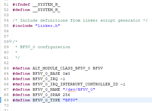

I have already done the OR-combine in RTL code of my IP, and output only 1 wire interrupt from my IP.
Currently, the problem is, the generate ID is still -1. please see the following picture.
If I manually change IRQ to 4 and ID to 0, the C code could successfully enter the ISR in my c code.
The weird thing is that I have to manually change the number after I click "generate BSP".

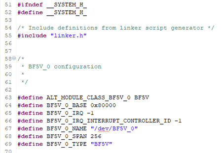

- StefanG_Altera8 months ago
I am not sure why the BSP builder is not generating the right macro header values (system.h) for your custom component.
Please try to use my component example as it worked on, my side. You may e.g. have some IRQ port interface settings not set right in your _hw.tcl file. Note: I used Quartus 22.1-std.
