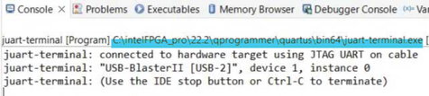

Hi, i'm trying to use riscfree vscode extension to debug my NiosV app. All is fine but i can't achieve to launch juart-terminal from vscode. Any idea ?

    I'm using win11. I don't have any error. Currently, i open a Nios V shell terminal and launch "juart-terminal -c 1 -d 0 -i 0" without any problem. But i'm trying to launch this just with one click.
