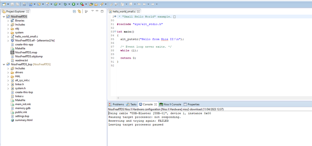

I downloaded the Nios 2 and started the project on Eclipse, it compiles and runs.
I want to update my project to pass the fast version of Nios with breakpoints.
After that, I regenerated the BSP and the project on Eclipse and compiled the project.

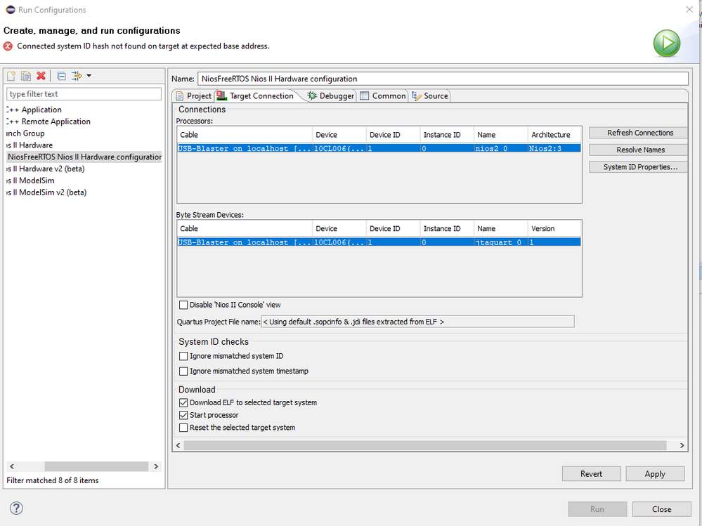

When I want to run the project the second time, I have this message, "connected system id hash not found on target at expected base address."

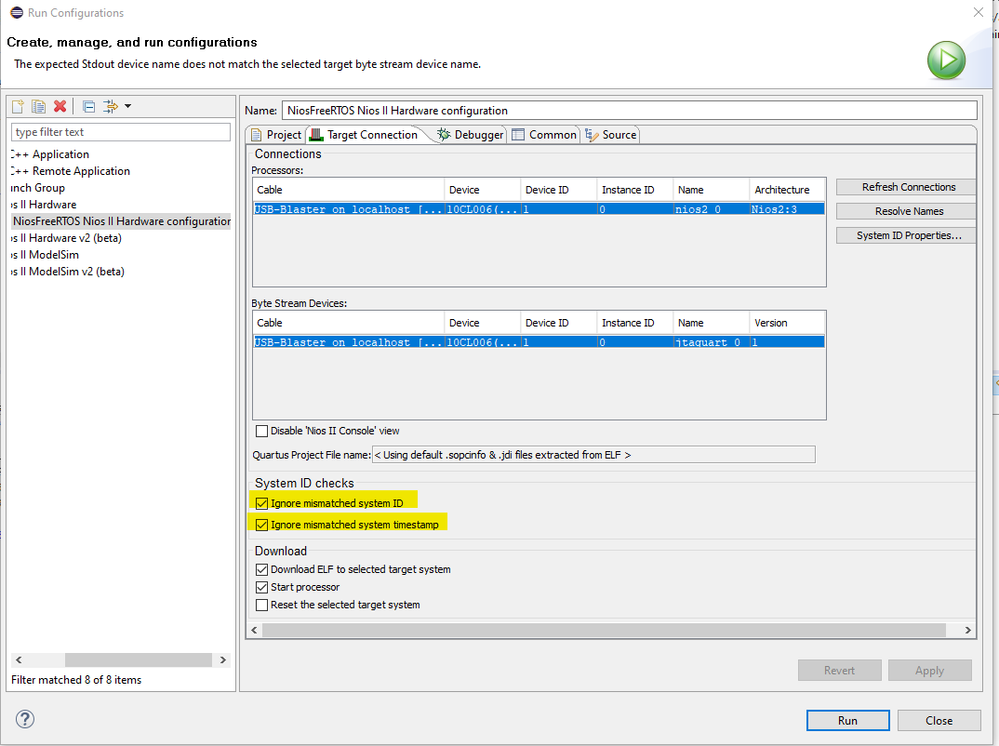

In the Target connection check the boxes ignore mismatch id and mismatch time stamp.
but still could not run the project.

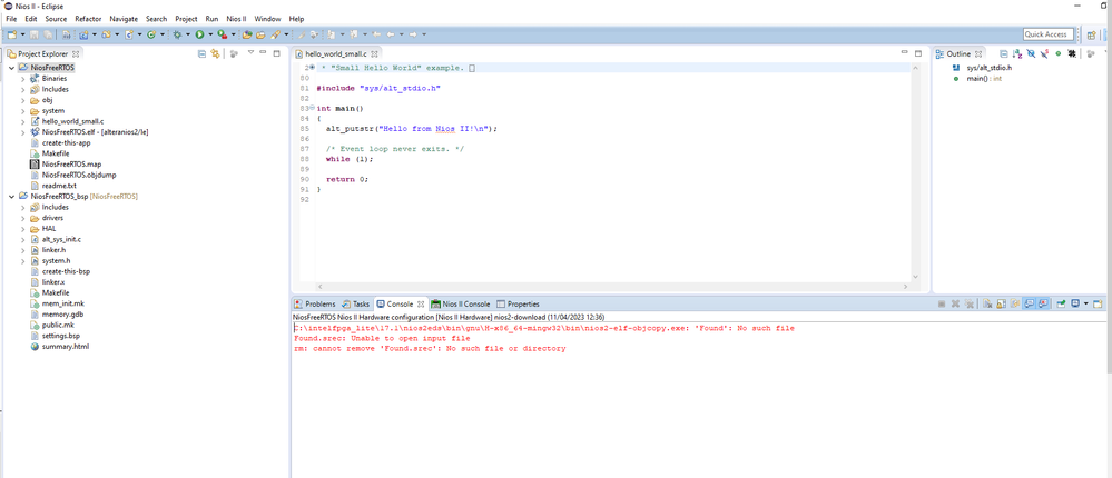

If I tick the boxes in the Run As Configuration that make Nios ignore the ID and timestamp values from the sys id, I get an error saying "Downloading ELF process failed". I think there must be something wrong with the communication with the board, but can't figure out what it is.

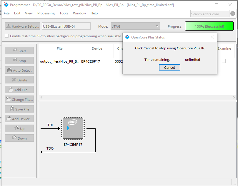

  • I think we have to leave this popup open,
    the second thing is that I installed a license I am not sure that it was a license issue but it works now!
  • Hi,
    I am tied up on my side, I am still looking into your issue, do you mean that you close the Quartus programmer after hitting 100%? Then it hits the error?
    or If you keep it open, (despite having it 100%) you will not get the error? Is this correct?
