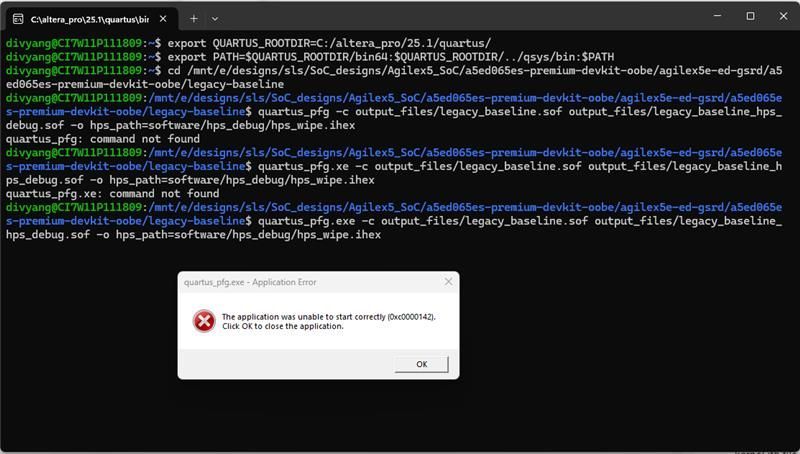

Thanks for testing it out. Let us know if re-installing Python makes any difference.
Meanwhile, our tools team have created a test setup with Windows 10 to list out the list of DLLs that are expected to be present for niosv-shell / qyartus_py. To find this on your Windows machine, use this Microsoft utility : https://learn.microsoft.com/en-us/sysinternals/downloads/listdlls
To run this, first launch niosv shell : c:\intelFPGA_pro\23.4\niosv\bin\niosv-shell.exe
Then from a new cmd shell, run : Listdlls.exe quartus_py.exe > out.txt
You can compare the DLLs listed in 'out.txt' with the list provided below by our tools team. For convenience, we've categorized the DLLs based on their source.
