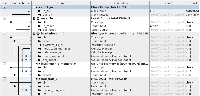

This is the platform designer:
As a first-time user, I hope this issue can be resolved. Additionally, I've been experimenting with oneAPI. However, when I attempted to do 'aocl install intel_a10gx_pac,' it returned an error stating 'Error: unsupported OS.' Could this mean that my OS version is not supported, or should I try using a different BSP? (oneAPI 2024.1)

      It seems like I forgot to assign the clock PIN on Arria 10 GX. Besides, when I utilized Nios V/M on Arria 10 downloaded from the design store, simply changing the part and assignment did not work. Therefore, I configured the Platform Designer from scratch. Anyway, it now works.
