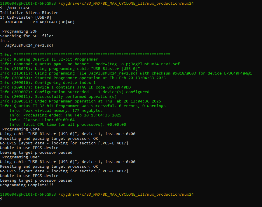

We have used to program our board device FPGA & Nios II using quartus 13.0 sp1 version tool by using the following commands
nios2-configure-sof JagPlusMux24_rev2.sof
nios2-flash-programmer --epcs --base=0x07006800 MuxReader_core.flash
nios2-flash-programmer --epcs --base=0x07006800 MuxReader_user.jtag
. For 3 months , we didnt program the device as we are working on the upgradation work.
today we tried to check the old board and flash file is not programmed properly. SOF is programmed properly. after that some message is printed as"NO EPCS LAYOUT DATA"
Please help us to resolve this issue.

We are using the same programming file which we used earlier to program the board. But now with the same flash file, facing no epcs layout issue. In board we are having EPCQ64A flash device only.
Is there any override file is needed for flash? Already we are having one override file .
I have attached the file with this.please check and let me know that is enough or not.
