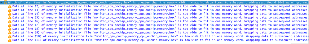

quartus report warings:
When I opened the hex file generated, I found that it was not in the right format.

  • Ahmed_H_Intel1's avatar
    Ahmed_H_Intel1
    you are missing one step, please replace step 3 "Select mem_init_install." with "Select mem_init_Generate"
