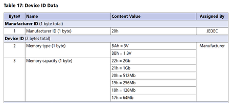

Hey,
At Nios environment, I am using the "Serial Flash Controller II Intel FPGA IP" in order to communicate with the Micron MT25QL256 memory device. This device is connected to the Active-Serial s...
