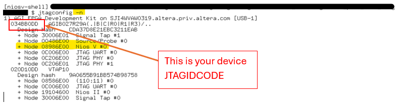

3)       TERMINAL#1: Identify the JTAGIDCODE and Start GDB Server
irst, display the connected JTAG device:
>> jtagconfig

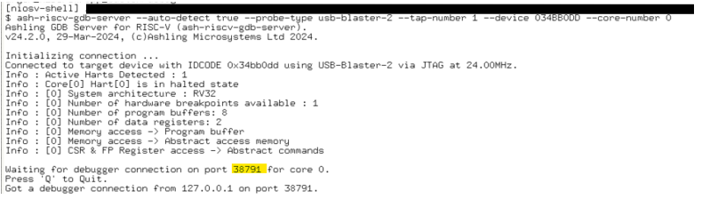

 Then start the Ashling GDB server and note down the port number (in this case is 38791):
>> ash-riscv-gdb-server --auto-detect true --probe-type usb-blaster-2 --tap-number 1 --device 034BB0DD --core-number 0

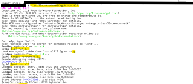

4)       TERMINAL#2: Load the ELF file
Launch GDB:
>> riscv32-unknown-elf-gdb run.elf
Inside the GDB prompt:
>> file run.elf
>> target remote: 38791
>> load run.elf

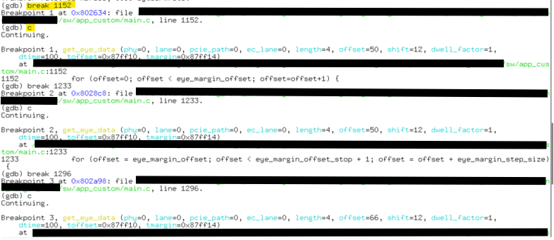

6)       TERMINAL#2: You may now begin debugging using standard GDB commands.
Set a breakpoint:
>> break <line number>
Continue execution until the breakpoint:
>> c
Step line-by-line
>> n
7)       Repeat Step (6) as needed - run, monitor output via JUART, examine behavior, and continue.

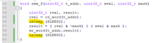

For example, the following operations in the function have been identified as the root cause of insufficient time between issuing rd_word and wr_word:
Use a large sleep value first to confirm that adding delay resolves the hang issue.
>> #define SLEEP2 10000
If the initial delay proves effective, reduce it step‑by‑step until you find the minimum acceptable value that prevents the hang.
>> #define SLEEP2 20
