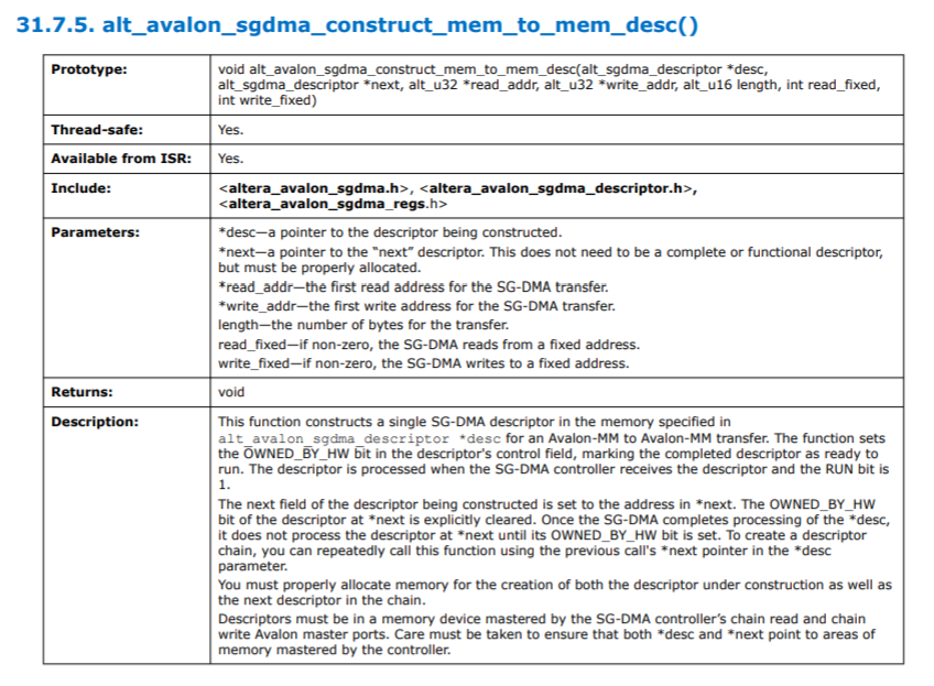

  • NurAida_A_Intel's avatar
    NurAida_A_Intel
    Dear MShro1,
    I've generated the simple socket example design and I believed you are referring to this prototype inside the simple socket design which is located inside altera_avalon_sgdma.h file.
    I found this handbook which have more details information about the SGDMA controller core in Chapter 31 (page 372) which may be helpful for you 😊 --> https://www.intel.com/content/dam/www/programmable/us/en/pdfs/literature/ug/ug_embedded_ip.pdf
