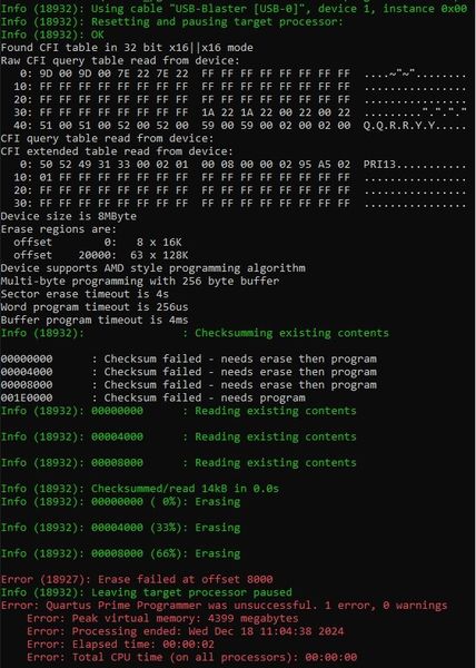

Hello, I'm trying to program a CFI 32-bit flash, composed by 2 16-bit flash in a parallel configuration, , using quartus_pgm/Nios Flash programmer (Quartus 18.1). Flash memories use AMD command set....

I'm not using PFL, I'm trying to use Nios Flash Programmer.
Is the 32 bit CFI (16+16 configuration) with AMD command set actually supported by Nios Flash Programmer ?
