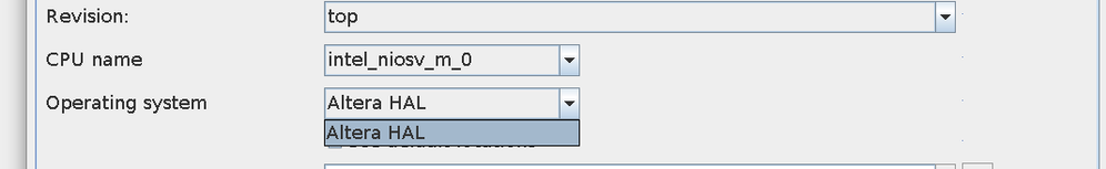

The same problem occurs using the BSP Editor in Platform designer: only the "Altera HAL" type operating system is available in the drop down menu:

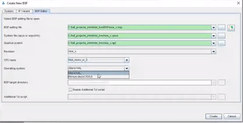

This screenshot from a tutorial video shows multiple options available for operating system type:

This might be due to this SOPC_KIT_NIOS2
Try running the whole Quartus in Nios V Command Shell or, you can set the SOPC_KIT_NIOS2:
- EBERLAZARE_I_Intel
