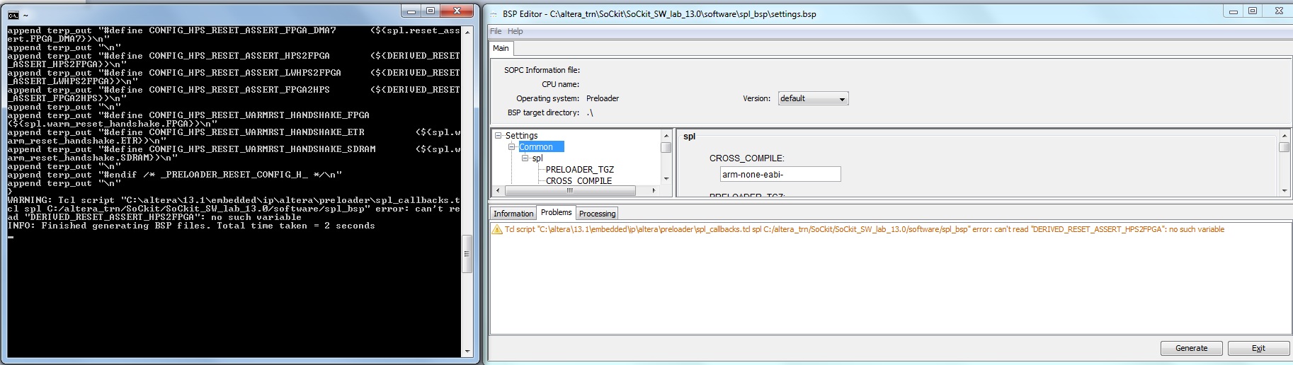

Hi guys,
I get this error:
- derived_reset_assert_hps2fpga: not such variable
when trying to "generate" from bsp-editor as described in "sockit_sw_lab_13.0" (exactly following guidelines...).
This causes I cannot generate all the files I need like makefile, preloader.ds and so on...
Any ideas/suggestion??
-antonioa

    I see that you are experiencing all the problems I had with SoCkit :(
    However, I remember I managed to get past this error using BSP-editor from the Quartus 13.0 version.
    In my opinion, Altera's SoC were released in a big hurry to catch up with Zynq family, so the documentation and examples could be written better. Let's hope we will get some decent (or at least working :) ) examples soon.
