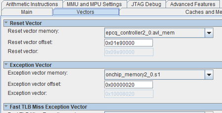

hi I'm trying to boot a Nios ii processor from EPCQ flash. I followed the steps described in the following (page 252 and on): https://www.intel.com/content/dam/www/programmable/us/en/pdfs/literatu...

6 years agoI have no idea why you put a delay on the NIOS II reset, BTW the main concern is the boot address, you must check the EPCQ flash datasheet to know the sectors inside this flash and know where exactly the correct address you should set to avoid overlay with .sof and give some buffer space to make the boot successful.
