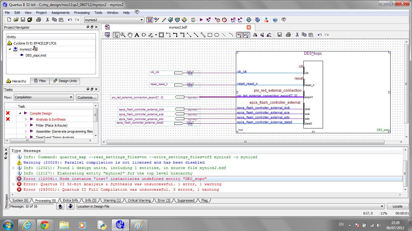

I am trying to run nios2 on my DE0-Nano, but i have some compilation problem.
I have Quartus2 11.1sp2 with the Qsys sopc builder. after i built the sopc and put it in a bdf file as symbol i compiled the project without success.
i add the screen print with the error, what should i do ?

    Maybe you haven't added the appropriate SOPC-Builder generated source files to your QII-Project.
    With QSYS the *.qsys-file is sufficient. Maybe the *.sopc-file is suffient with SOPC-Builder.
    Otherwise you've to look for a *.qip-file or, at worst, add the files manually.
