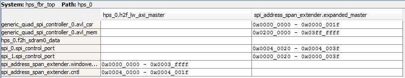

Hi All,
How should I understand the generated Address Space in HPS (attached please find the snapshot)? Why the address space of hps_0.f2h_sdram0_data is empty? Should i define it manually? http://www.alteraforum.com/forum/attachment.php?attachmentid=11505&stc=1 Thank you1 Reply

maybe you have not connected anything inside qsys to that port?
