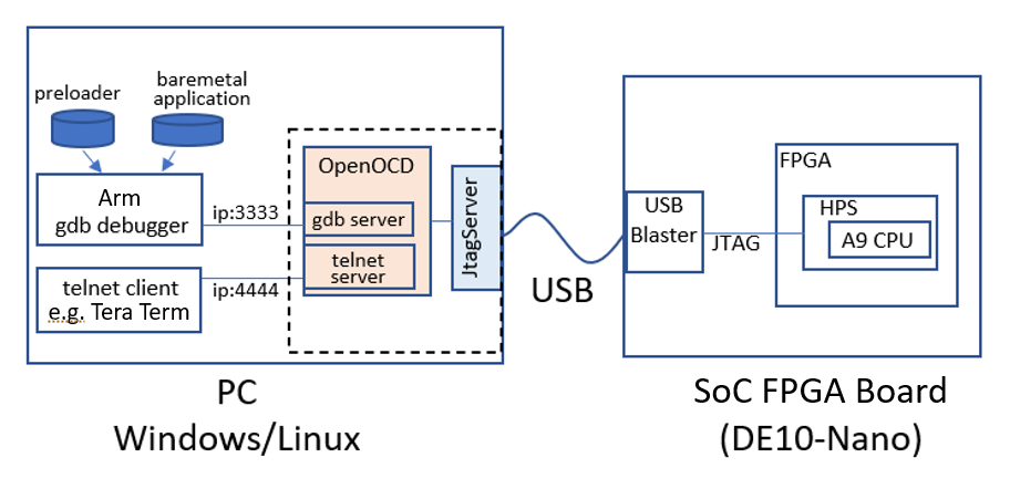

Overall Structure
This section outlines the tested configuration.
Hardware: The debugger PC and the FPGA board are connected via JTAG (actually using an OnBoard USB Blaster, so a USB cable). The PC can be either Windows or Linux.
PC Software: OpenOCD is kept running, with the gdb server accessing the USB Blaster being active. The gdb debugger for Arm CPU is connected to the OpenOCD gdb server to facilitate debugging, which includes code downloading and execution.
