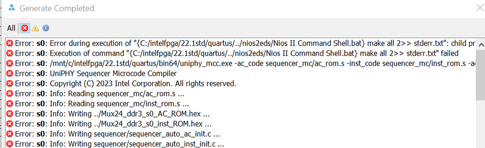

I am facing this wsl patch issue in quartus 22.1 prime tool, i have installed wsl patch also.
please guide me to resolve this issue.

Hi there, which patch you have installed? And according to the second picture you shows, can you switch the version to 18.0.4 and try again.
- SERMASWATHIKA
Contributor
thankyou now issue resolved.

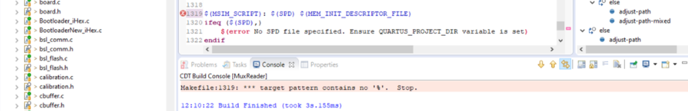

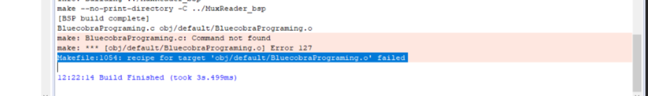

our firmware team tried to generate the bsp builds for the upgraded design and facing some issue in that. the following snipet shows the error.
after commenting the portion, again below errors are reporting,
can you please help us to resolve the issues?

The screenshots are unclear, The error msg is blurry.
