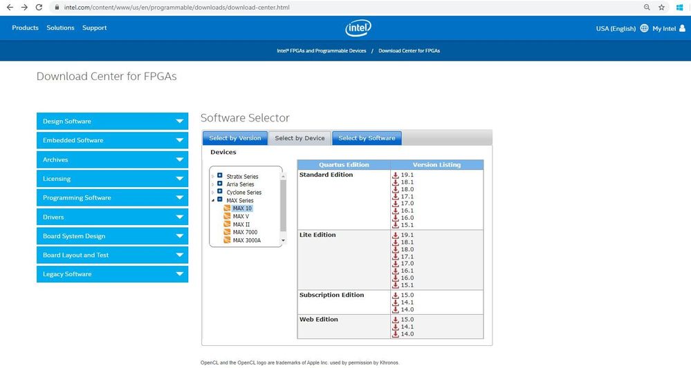

    I am Using the MAX 10 FPGA, trying to program it using a window XP PC
  • IXi00's avatar
    IXi00
    Hi Vicky, I tried the link that you provide, It's for 64 Bit.
    The reason why i need version 14 and above is because i am using MAX 10 FPGA where only version 14 and above able to support
  • IXi00's avatar
    IXi00
    But the link that you provide, the installer is in 64 bit version, i tried it and it doesn't work

    • On Altera's info page: https://www.altera.com/support/support-resources/download/os-support.html From the table footnotes. I highlighted a couple of items. starting with acds v14.0, intel fpga software only supports 64 bit versions of the os listed in table 1, unless specified.
    • The 32 bit library files are required to run the software on Linux* 64 bit platforms.
    • Windows 8.0 only.
    • Both 32 bit and 64 bit are supported.
    • Only KDE desktop manager is supported.
    • 32-bit standalone programmer is only supported in standard edition.
    So in your case MAX 10 device only available in Q14.0 onward versions so you need to use 64 bit operating system to use MAX10 devices
    Alternatively if you use Quartus Standard Edition (PAID version) of the tools it appears a 32 bit version of the standalone programmer tool is supported.
