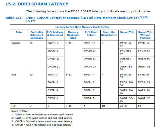

Uniphy DDR3 SDRAM Latency
I came across below table in the External memory Interface handbook Volume 3. Could you further explain what are the Even Write, Even Read, Odd Write, and Odd Read?

    I believe these odd write latency and odd read latency are the setting we set in the IP.
    • Odd/even is the number we set. Example, 5 (odd) or 6 (even).
    • write latency is CL = CAS latency
    • read latency is CWL = CAS write latency
