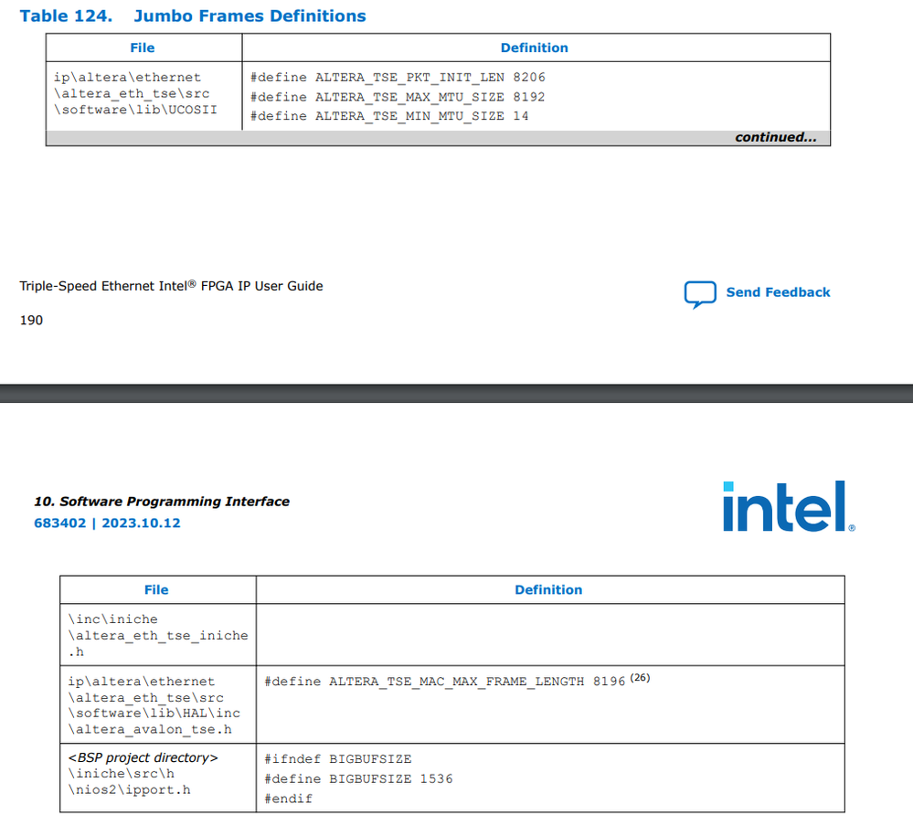

I'm using QSYS 18.1 with Triple-Speed Ethernet IP set for: 1000BASE-X/SGMII PCS Only with Stratix IV.
I want to use it for Jumbo frames, and I read the IP User Guide section 10.5 which shows the Jumbo frames' definitions as shown in the figure below:
I tried to change the definitions according to the above, but it seems that the QSYS / generated BSP not using these files. they don't compile them. I assume because of the PCS only option.
Is there a way to set the Jumbo frame for my settings, or what I'm I doing wrong?

We don't have error during compilation, but we understood that the limitation comes from the switch we are connected to.

May I know what do you mean by it doesn't compile? Any error during compilation?
