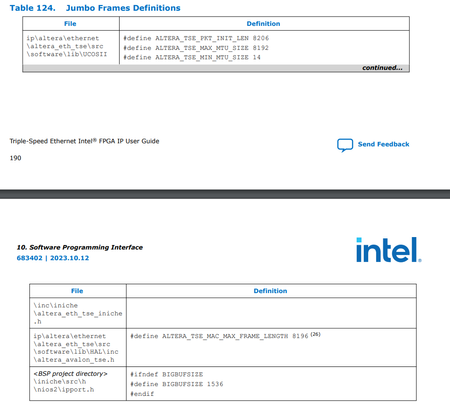

Hi, I'm using QSYS 18.1 with Triple-Speed Ethernet IP set for: 1000BASE-X/SGMII PCS Only with Stratix IV. I want to use it for Jumbo frames, and I read the IP User Guide section 10.5 which shows th...

We don't have error during compilation, but we understood that the limitation comes from the switch we are connected to.
