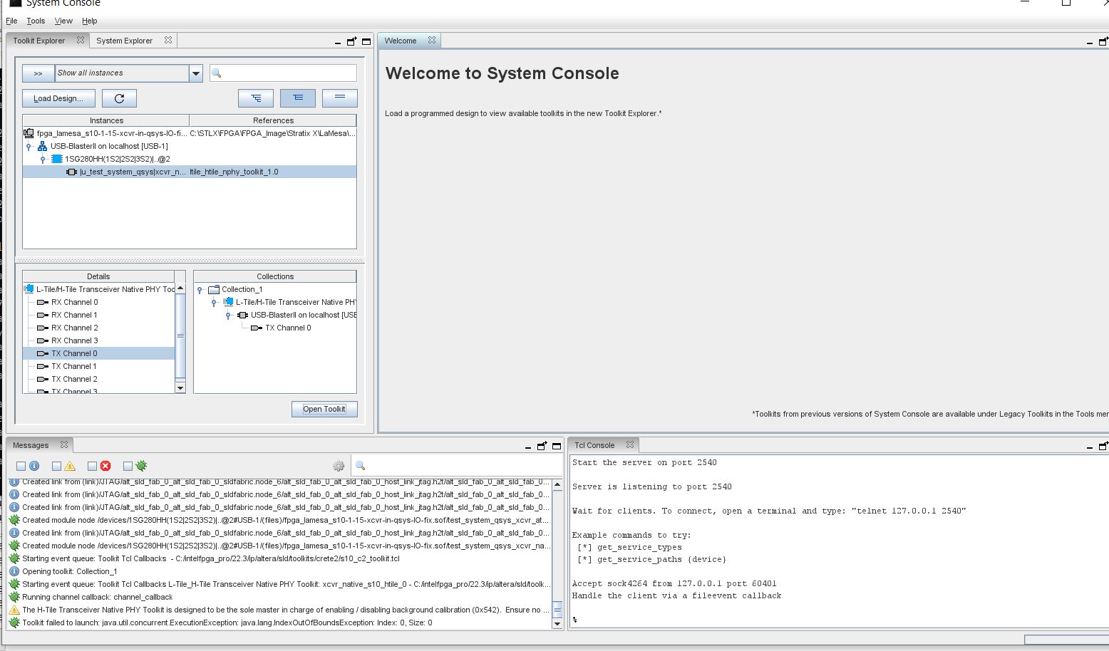

Attached are 2 screenshots of
- Successful read of read-only registers 0x481 (value of 0x34 returned in sysconsole, but readdatabus says 0x000)
- Bus hangs when trying to read register x0.
Also another issue is that Transceiver Toolkit crashes with java error. Could be related to the r/w problem to reconfig bus.
