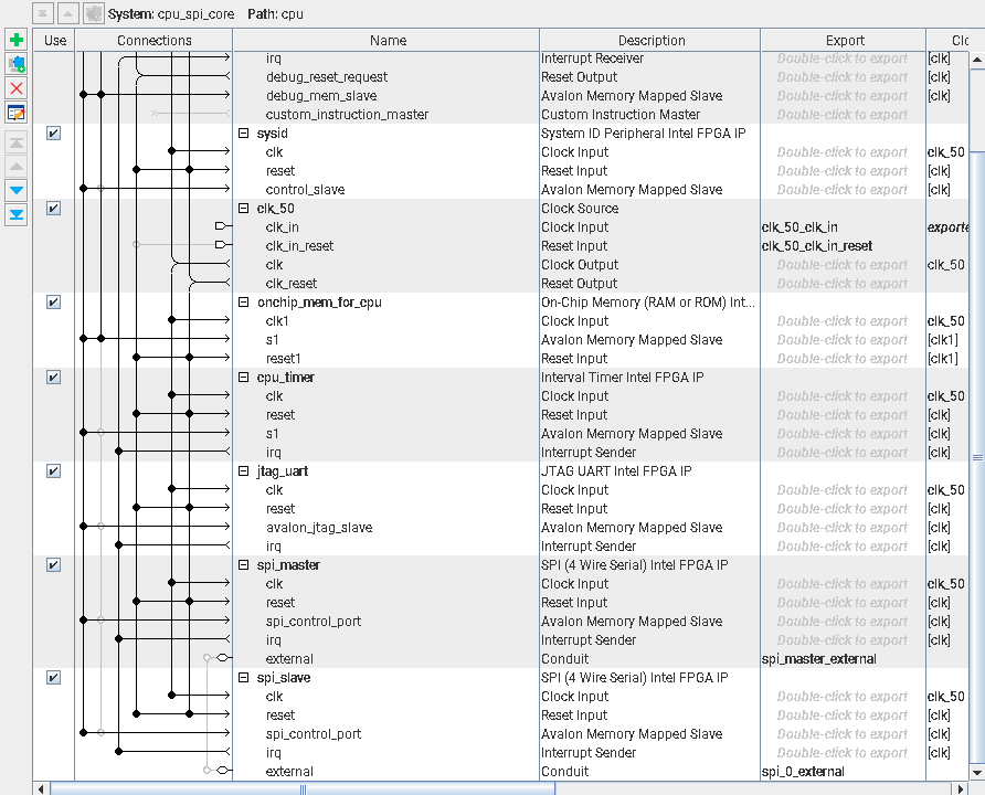

You may checkout this example design https://www.intel.com/content/www/us/en/design-example/715042/max-10-spi-slave-to-avalon-master-bridge-for-max10-dev-kit.html and modify a bit the platform designer system so that the spi master is connected to slave device like screenshot attached below.
