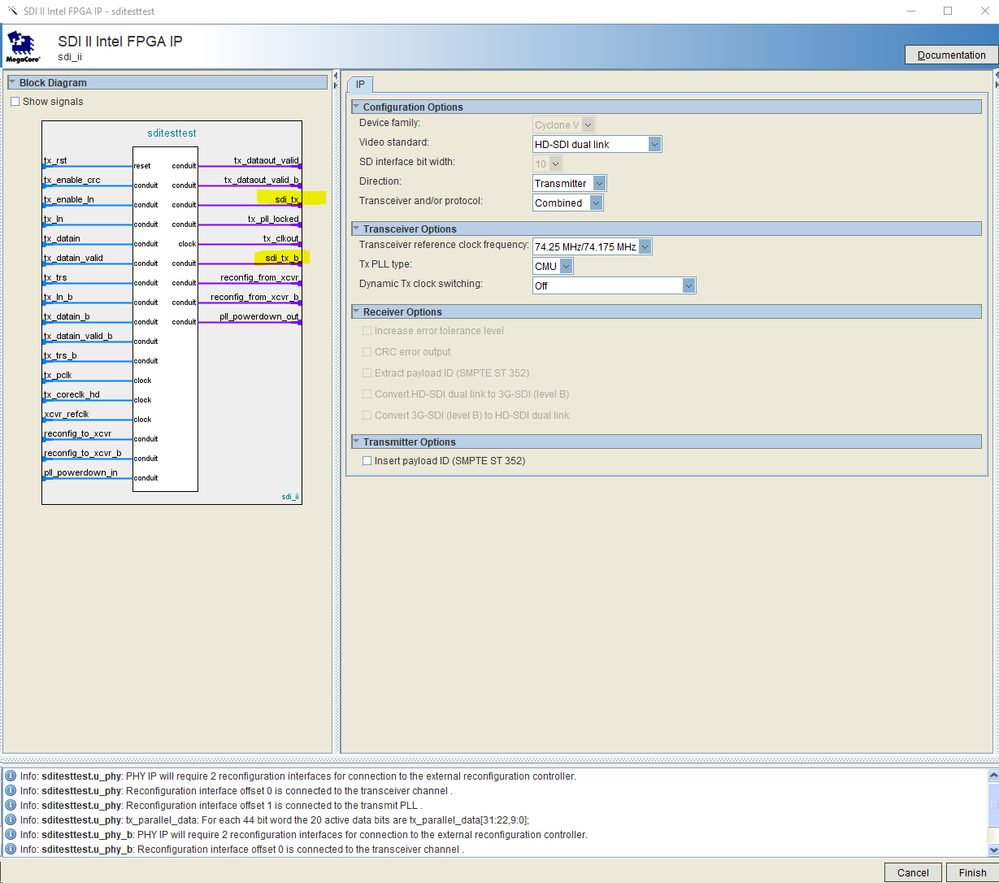

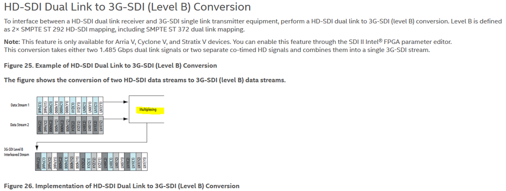

    I have got a question to the SDI II IP Core. I want to operate it in HD-SDI Dual Link to 3G-SDI Conversion Mode.
    The documentation states the following:
    So, my understanding is to have 2x synchronous HD-SDI streams as an input. And the SDI II IP Core will generate a single 3G-SDI data stream from this data.
    Is the block “Multiplexing” part of the SDI II IP Core?
    I tried to configure the SDI II IP Core for this purpose, as shown in the figure below. My second question is, why do I have two SDI outputs? “sdi_tx” and “sdi_tx_b”?
    I expected only one output with a multiplexed data stream.
    Can you please explain?
    Thanks and best regards,
    David

      Hi cpchan!
      Thanks for your answer. I'm using Quartus 18.0.0 and the Cyclone V 5CGTFD9E5F35I7 device.
      David

  • DB's avatar
    DB
    Hi cpchan!
    Thanks for your answer. But this was not my question. Sorry.
    My Intention is to realize the following:
    Generate two synchronous HD-SDI Datastreams in the FPGA and transmit them in a single 3G-SDI Datastrem.
    So, I have two times parallel SDI Data in the FPGA and want to connect them to a SDI II IP Core (Transmitter). The core should generate a single 3G-SDI stream.
    How to parametrize the SDI II IP Core?
    Thanks!
  • CheepinC_altera's avatar
    CheepinC_altera
    Sorry for the confusion. Thanks for the clarification. As I understand it, you would like to convert two parallel HD SDI data streams into one 3G SDI serial data stream to be sent out. For your information, this is not supported by the SDI II IP. The SDI II IP can take in two serial HD-SDI data stream and convert to one 3G parallel stream. Sorry for the inconvenience. You might need to look into coding your own converter to merge the two parallel HD SDI into a parallel 3G SDI before feeding to SDI II IP (configured in 3G mode).
