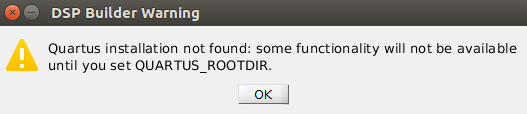

Quartus installation not found: some functionality will not be available until you set QUARTUS_ROOTD
I am trying to run the DSP Builder verify option from Simulink DSP Builder menu. But, I am getting this error.
I have checked the root directory from MATLAB command window, getenv('QUARTUS_ROOTDIR'), and it shows the correct directory, i.e., /home/user_name/intelFPGA_pro/21.3/quartus/bin
Please help to resolve this issue.

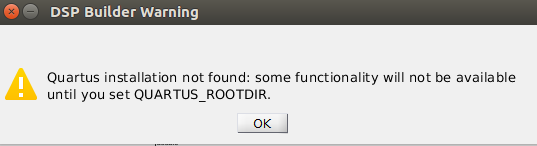

    Matlab opens with the following notification

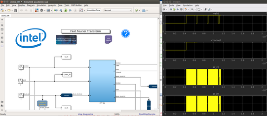

    4. From the DSP Builder tab on simulink new file window, open an example file. The simulation is working fine.

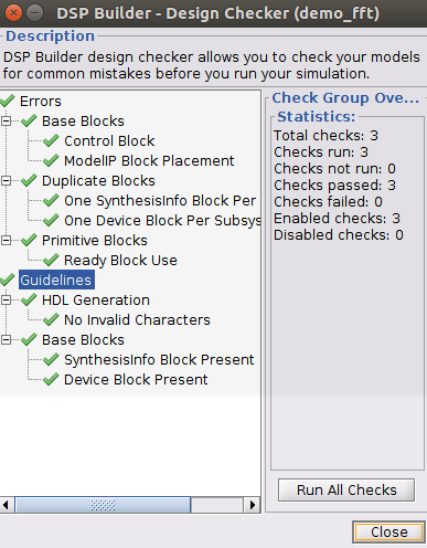

    5. Then Design checker option from DSP Builder menu is working fine.

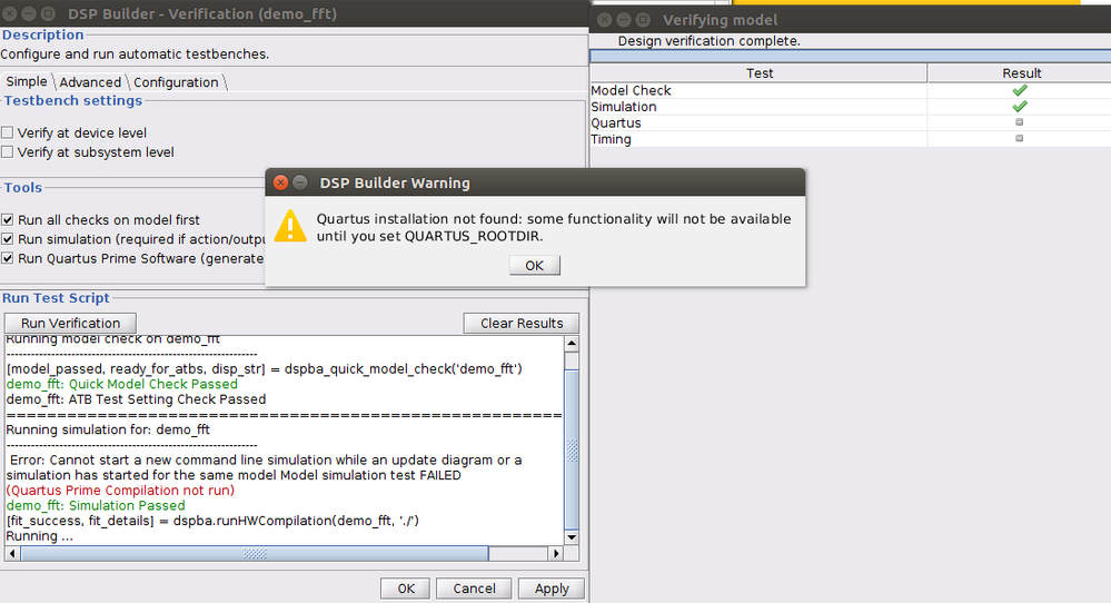

    6. Then the verify design option from DSP Builder menu, brings the error again.
