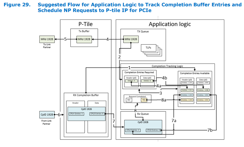

hello, i wonder about the pcie protocol.
If you request 4096B from memory read, the completion will return 8 of 512B, but according to the avst interface, there is a module that determines whether the completion buffer has received all the completions.
In this module, if the request is not completed because all completions have not come, can CPLD in Rx queue fail to transmit?
(Eight 512B CPLDs must arrive, and only then do they transmit together?) Or are they transmitted one by one after checking only the buffer?
I'm sorry that I can't speak English well.
Thank you for your reply.

    In a typical system design, when you request 4096 bytes from memory read, the system may choose to split the request into smaller chunks for efficient processing. In your case, the completion returns 8 chunks of 512 bytes each. The completion buffer is likely used to hold these individual chunks until all of them have arrived.
    Regarding the behavior of the CPLD in the Rx (receive) queue, it depends on the system design and the specific implementation. If the system requires all eight 512-byte chunks to be received before transmitting anything, the CPLD may indeed wait until it has received all the completions in the buffer before transmitting them together.
    You can enable the RX buffer limit port to control the buffer limit on the CplD packet under page 138
    https://www.intel.com/content/www/us/en/docs/programmable/683059/21-1-4-0-0/introduction.html
    Let me know if you need any further clarification.
