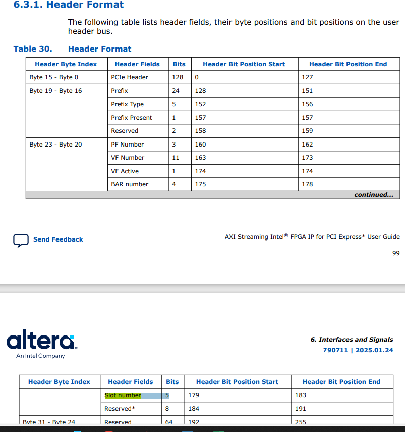

PCIe AXI Streaming IP Packet Header Slot Number Details
Is the Slot Number information provided in the PCIe header (AXI Streaming IP, Document ID: 790711) the same as the Physical Slot Number of Slot Capabilities Register [31:19] defined in the PCIe Base Specification?

    "The former is used for transaction routing and identification," which can be achieved by Bus and Device numbers or using the Address mapping to BAR. How does this field differ from them? Could you provide more details?

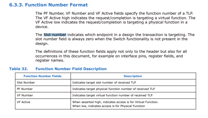

    • Wincent_Altera's avatar
      Wincent_Altera
      Hi ,
      Detail about the slot number, you may refer to the user guide under section 6.3.3
      let me know if you need further clarification.

    Hi Wincent,
    Thanks for your response.
    How will the mapping of these end-points based on slot number be done? Is it handled by the main system in the Hierarchy (Root Port) or by the user through user-defined interfaces?
