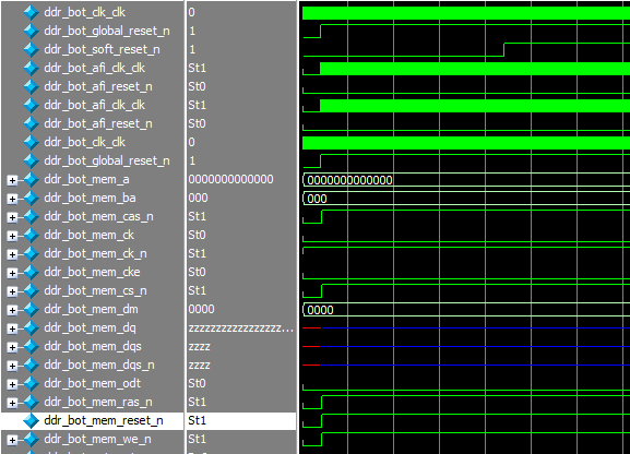

i have ArriaV, DDR3 chips, but after deassert global and soft resets mem_reset_n stay is low. Soft reset generate after 1000 tick on 100MHz clk
What else can affect this signal?

But since you're facing some issue with the Arria V device, can you use the example design to simulate your IP in the Arria V?
- EBoln5 years ago
I try to simulate... and all signals correct
