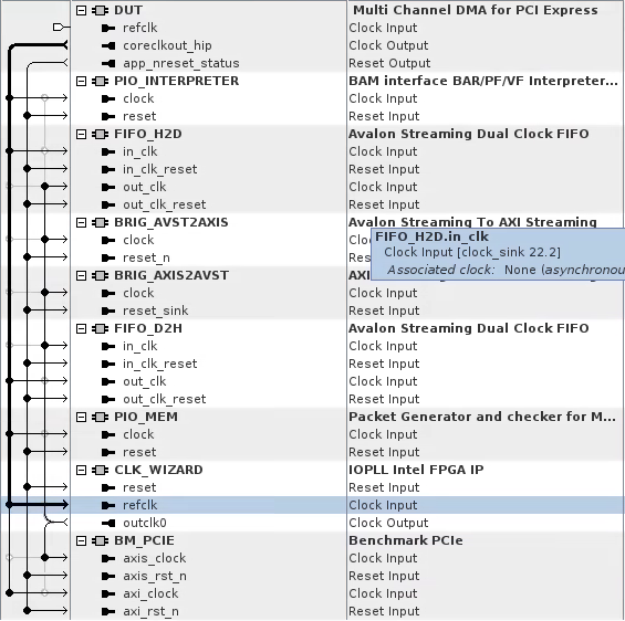

Hi Wincent,
I used the example design provided in Quartus. Running PIO transfer, gencheck, loopback seem OK.
Then, I want to insert our accelerators to receive data from the HOST, doing computations, and send back results to the HOST.

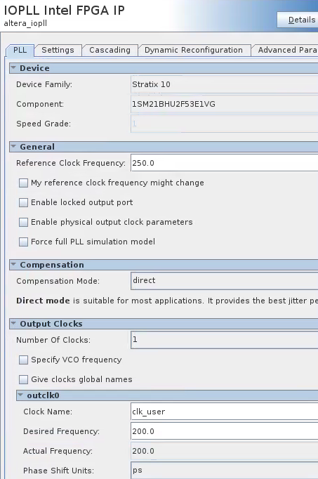

I want to run these accelerators at a lower frequency (200MHz), so I pulled PLL core which uses coreclkout_hip as the reference clock.

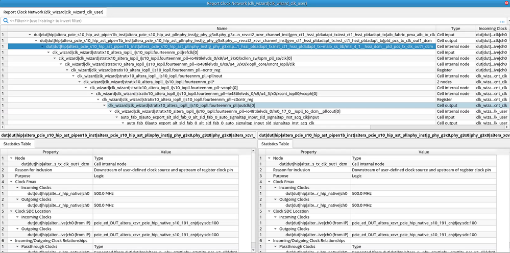

But when re-checking TA clock report, it showed the output clock freq = 400 MHz and refclk = 500 MHz
@Wincent_Altera wrote:Can you check if you enable two clock together ?
Could you clarify this? I could not see where to enable two clocks when pulling the MCDMA IP Core.
There is only 1 selection regarding frequency: "PCIe gen3 x8 - 250 MHz"

Sure! This is the PLL configuration
And the system view with clock interfaces
And this is what clock report with the final snapshot
- clkout of the IOPLL
- And clock network report
