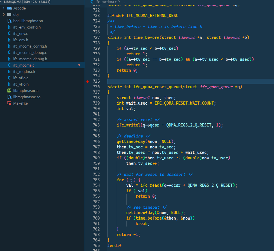

We checked the sequence of channel initialization, queue reset, and resource management and made sure it was according to the official guide, but still the problem persists, nothing unusual was found in desmg log. Therefore we used gdb to check the actual line of code where the problem was occuring.
According to our analysis, problem occured in queue_reset function of ifc and mostly due to timeout being exeeded. Therefore we commented out the timeout block and re-compiled the libmqdmasoc.so lib and the problem resolved, and we are able to create the desired number of channels.
The natural doubt which occured to us was why was the timeout present in the code in the first place ?, Why is that value defined to be 2048 micro seconds?
If we comment it what drawbacks we will get ?
Please give us concrete reasoning.
I am attaching the screenshot of snippet of queue reset function call which is present in ifc_mcdma.c file.

Based on my understanding.
- reasons for its presence - Without a timeout, if the queue reset bit never deasserts (for example, due to hardware malfunction or misconfiguration), the process would get stuck in an infinite loop. The timeout allows the software to detect hardware problems and handle them gracefully (log, clean up, alert the user, etc.).
- Why 2048 Microseconds - The value (2048 µs) is likely chosen based on typical hardware reset response times, with a margin for variability. Most hardware queue or register resets are expected to complete in a few microseconds to low milliseconds.
- If you comment out the timeout - that could potentially cause the hardware or logic ever fails to deassert the reset bit, your code will hang forever at that point, leading to a stuck process or system.
I recommend you to consider to increase the timeout value that suit with you system , for example 10000us or more.
