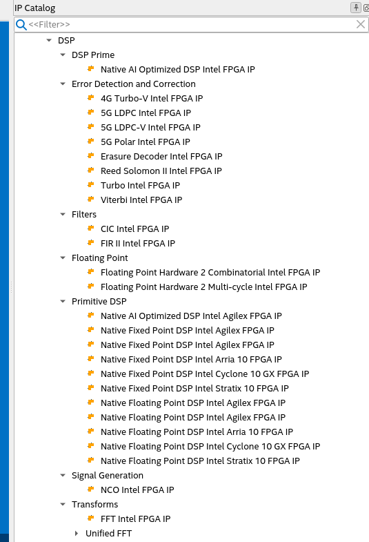

There are multiple IPs available for the DSP. Sharing screenshot below.
The best option you can choose to use the DSP Builder for Intel FPGAs. For more info refer to DSP Builder for Intel® FPGAs (Advanced Blockset): Handbook
You can also refer to the IP 1. SDI Audio Intel FPGA IP Overview.
If you need any specific info w.r.t. your application and hardware architecture, I recommend contacting Intel FPGA FAE or any intel FPGA partner supporting in your region.
