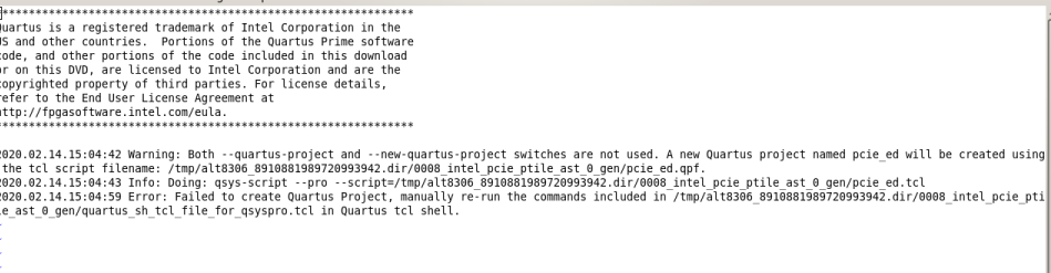

Intel p_Tile Avalon ST for pcie IP unable to generate example design in quartus 19.4 version for stratix 10 device.
Hi tried to generate example design for Intel p_Tile Avalon ST for pcie IP stratix-10 device. I selected the IP mode as GEN3x8 256 bit, native point, 250mhz. While trying to generate example design it shows error attached.

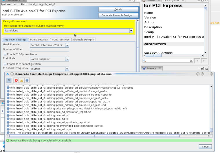

    I tried the same setting in my machine using 19.4 and the example design can generate without any issue.
    Maybe you can try with other machine or re-install the quartus.
