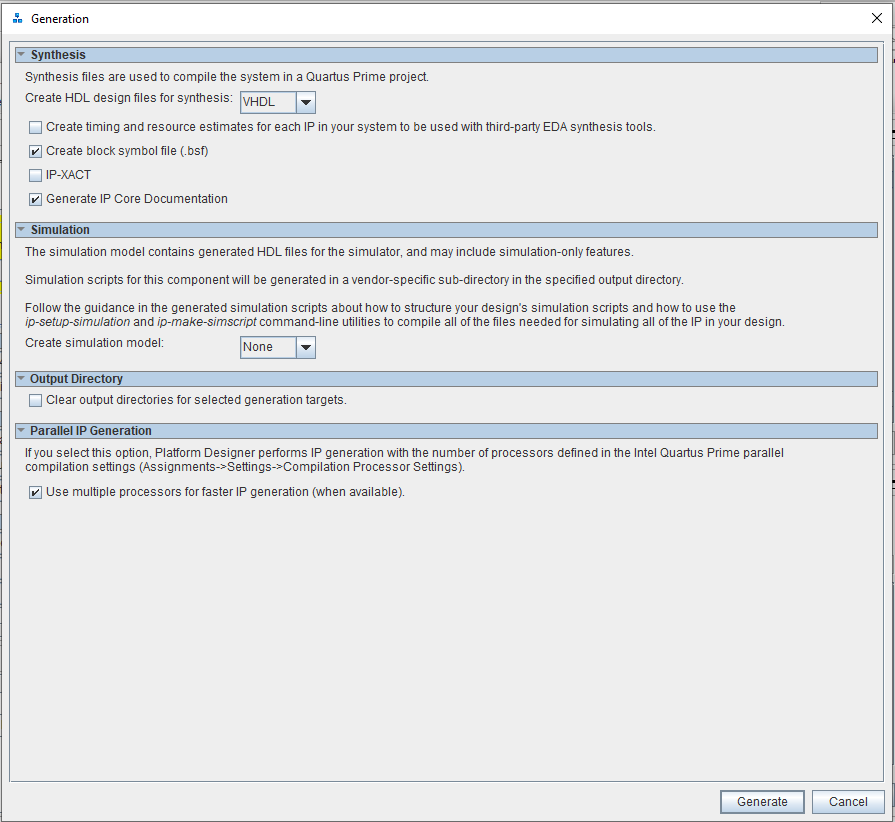

When I generate an IP core to evaluate (FFT for example), I use these settings
All I do after that is add the .ip file to the project. Once it is added I get this message:
I have gone through every setting tab and made sure all the settings are the same as a blank project (signaltap off, logic analyzer off, simulation tool none). I have also tried deleting any qdb folders, the tmp-clearbox folder, the .qdf file and any .bak files related to settings.
If I don't have that fft ip file added I can generate regular .sof files fine and I have other IP that I have already purchased included in the project.
