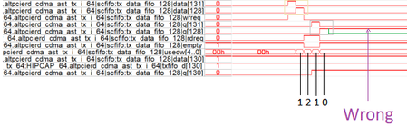

still think that it's a misinterpretation of tx_st interface data. st_data and st_sop and st_eop are only valid while st_valid is active. I know that in typical Avalon ST examples, sop and eop are reset together with valid, but as far as I understand, it's not required by the specification. See this explanation of valid signal:
Asserted by the source to qualify all other source to sink signals. On ready cycles where valid is asserted, the data bus and other source to sink signals are sampled by the sink, and on other cycles are ignored.Regards,

Hello FvM,
"I know that in typical Avalon ST examples, sop and eop are reset together with valid, but as far as I understand, it's not required by the specification. See this explanation of valid signal"
After further observations, I think your explanation is correct.
Thank you very much
