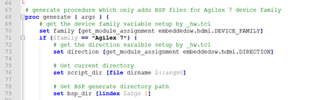

dscully
3 years agoHDMI BSP Driver No Longer Included in Quartus 23.2 for non-Agilex 7 Targets
Hello, I have a Arria 10 project using the Intel HDMI 2.1 core in AXIS-VVP Full mode. The board support package (BSP) generation reports that the "intel_hdmi21_driver" is detected for inclusion. How...
