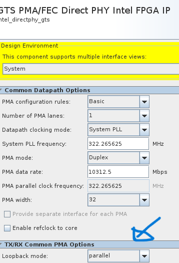

      Is it necessary to edit these AVMM registers in order to get a loopback running?
      Or will the default loopback setting:
      Suffice to get a loopback, along with this tx-rx serial setup:
      assign gts_i_rx_serial_data = gts_o_tx_serial_data;
      assign gts_i_rx_serial_data_n = gts_o_tx_serial_data_n;
      qsys_top soc_inst (
      .intel_directphy_gts_0_o_tx_serial_data_o_tx_serial_data         (gts_o_tx_serial_data),
      .intel_directphy_gts_0_o_tx_serial_data_n_o_tx_serial_data_n     (gts_o_tx_serial_data_n),
      .intel_directphy_gts_0_i_rx_serial_data_i_rx_serial_data         (gts_i_rx_serial_data),
      .intel_directphy_gts_0_i_rx_serial_data_n_i_rx_serial_data_n     (gts_i_rx_serial_data_n),
      Many thanks,
      K
      • ProFromDover_Altera's avatar
        ProFromDover_Altera
        Have you looked at section 6.12 of the GTS Transceiver PHY User Guide: Agilex™ 5 FPGAs and SoCs?
        It states:
        • The example design runs an external loopback test by default, with the loopback_mode parameter set to 0.
          To perform an internal loopback test you must set the loopback_mode to 1 in the parameter.tcl file, located at: <design_example_dir>/hwtest/src/
        • If needed, update the JTAG port ID by modifying the jtag_port_id parameter in the same file. The default value is 0.
