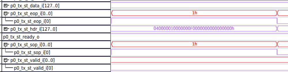

You may need to recheck your design if a given valid is not seen by the IP.
Here is how a F-Tile RP reads another FPGA's VID.
Hello Rong,
When using a Configuration Write or Read Request the address is compose of : Bus Number(7:) & Device Nb(7:0) & Ext_Reg(7:0) & reg Nb(7:0).
So what you see is the Bus Number=01h and Reg Nb=10h.
By the way, I have the same behaviour with the address=00h (Device ID & Vendor ID) in the Configuration Space.
Thanks for help.
Serge

- The sequence I am doing is the following :
- Using the configuration Bus :
- Read @82h to get Link Rate and Link width
- Write 00h at @18h
- Read @18h to check previous Write
- Write 01h at @19h
- Read @19h to check previous Write
- Write 01h at @1Ah
- Read @1Ah to check previous Write
- Write 00h at @1Bh
- Read @1Bh to check previous Write
- Write 06h at @04h
- Read @04h to check previous Write
- Read @78h to get RP Dev CTRL register
- Read @79h to get RP Dev CTRL register
- Read @7Ah to get RP Dev CTRL register
- Read @7Bh to get RP Dev CTRL register
- Read @74h to get RP CAP Payload Max
- Using the Avalon Stream Bus
- Configuration Write type 0 End Point BAR0 with FFFFFFFFh @10h
- Wait for completion (Completion received)
- Configuration Read ype 0 End Point BAR0 @10h
- Wait for completion (Completion NEVER received.
Please let me know if you need any other information.
Thanks for help.
